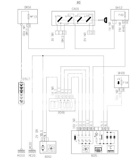

RussB
Posts: 4
Joined: Thu Feb 25, 2016 2:52 pm
Re: 206 Heater problems
Post by RussB »
Thanks Ian,
The wiring diagram gives this thick of better understanding of the set up.
Did the bump start test this morning, as soon as the engine started on the bump, the blower cut out.
I turned the blower switch to "off" and drove the short distance back home. Before I turned the engine off, I tried the blower again and it worked with the engine running.
