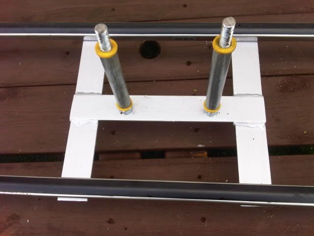

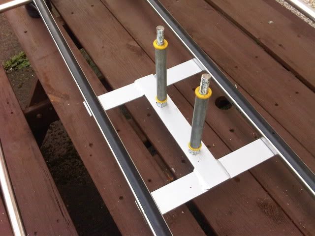

the intension was to carry a spare in the boot and put the luggage on the rack, i then got thinking why not put the spare on the rack and the luggage in the boot so set about making a bracket,
i have a spare full set of alloys that i'm in the middle of referbing so fitting off the car and measuring was easier

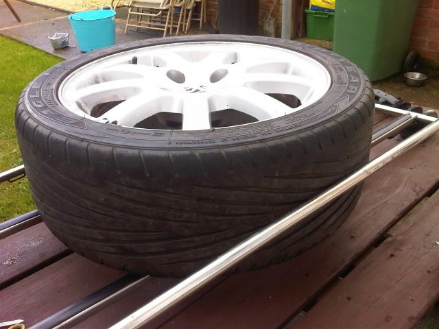

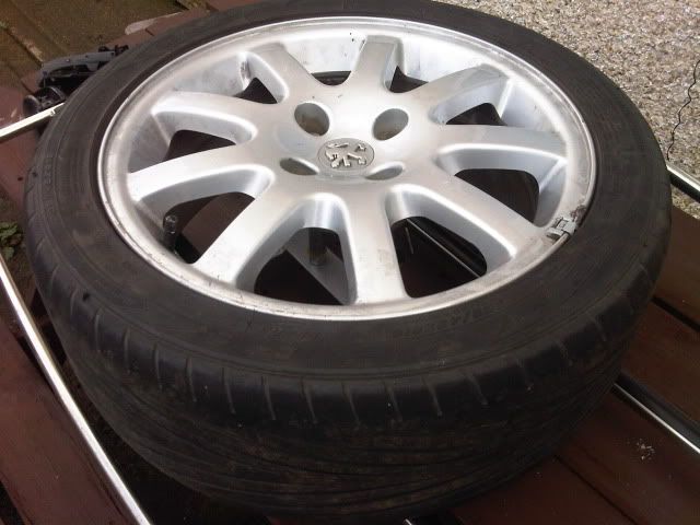

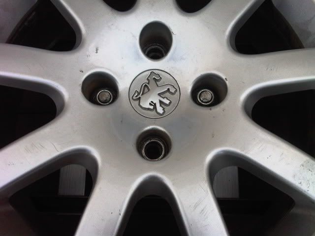

secured in place with 19mm locking nuts
protection when wheel taken off
all can be removed in less than 5 mins just leaving the H bracket in place for luggage as designed. just waiting for the wheel cover to arrive then it will be fitted to the car on a sunny day with the roof down for some proper pics of it in situ.
