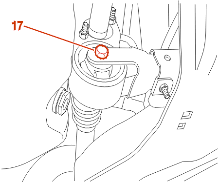

i been told jack up car put on axel stands and then jack up with wood the engine carefully to take tension of mount .. but when i looked under before started raining .. i can see a metal bracket 3 bolts and a wheel of sumsort ..how it all go togther ..or can someone draw me how to take it off and refit .. as dont know what bolt to take out first etc

this is the bracket i think it hard to see underneath as it was dark and started to rain
but on this if i have to replace to stop it wobbling what would i change
i cant find a pic of this mount assembled anywhere on google

From your diagram-
Unbolt the lower bracing bracket (18) from the sump.
Unbolt Engine mount fork (13) from subframe and remove centre bolt (16) from the void bush.
Unbolt engine mount bracket (12) from rear of engine and remove from car.
You now have two choices to change the void bush.
#1-Take the bracket and new bush to your local garage and get them to press it out and press new one in.
#2- Use a vice and suitable size sockets as press tools and change it yourself. You will need a socket a tiny bit smaller diameter than the bush to push it out, and a larger socket or short piece of tube as a *receiver* to bush the bush into.
*NOTE* the bush has to be orientated in the same way as the one you remove (ie the *voids* in the new bush should be in the same direction as the one you take out.
Use the same socket you used to push the old bush out to press the new one in.
Then put it all back together in the reverse order.
It might help to have an assistant to push engine backwards or forwards so you can get the bolt back in the centre of the bush as the engine will tend to move fore or aft once bracket is removed. This is normal and not a problem.
